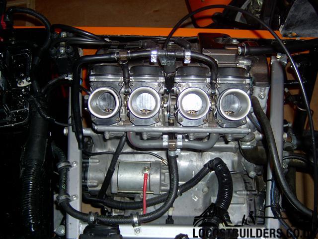

1997 blade engine,standard airbox and filter standard mk manifold going into a cat then to standard mk silencer..
[img]http://Forum Code: [/img]
straight picture of engine with airbox removed.

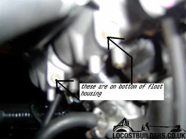

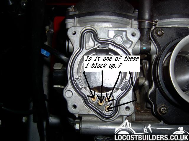

Is it one of these i need to block and is there a certain way of doing it (i suppose i will do a temp test first)

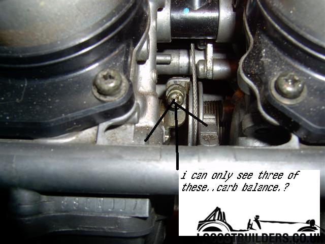

Carb balance screws.?

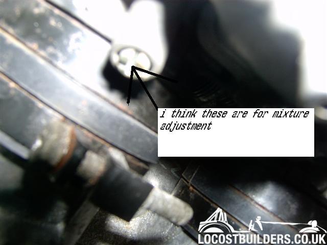

I think these are mixture screws..i think they only adjust at idle.?

Hi yes they are the mixture screws and balancing screws. There are only three balancing screws because you set them up to the carb that hasn't
got one (carb 3 think). The mixture screws adjust the pilot jets effective up to about 3-4000 revs before main jets take over.
We are running our mixture screws at about 2 turns out ATM without blocking any extra tubes etc and seems to run fine.
The screws on the bottom of the float bowls are to drain the fuel out.

Ian Gray off Stuart Taylor Motorsport told me to bolck the very middle hole.

I think the screws in the bottom of floats are just drainage screws.

Mine has 3 carb ballance screws. You ballance carbs 1 and 2 with the end one. you ballance carbs 3 and 4 with the other end one and then ballance the
two pairs with the centre one.
Clear as mud eh?
