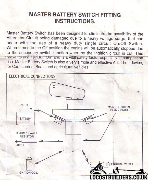

| posted on 19/1/07 at 02:08 PM |
Hi a copy of the instructions for any one who may need them.
[img]http://www.locostbuilders.co.uk [/img]
cheers matt
