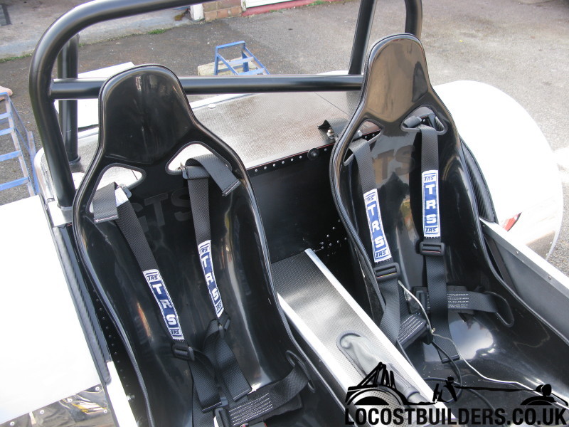

Really clean, lovely looking build you should be proud to present that at SVA. The only one bit I can spot but will be debatable is the harness upper mount heights. They look a bit low but you never know.
Well done,
Oh yes and the front spring platform adjusters, some SVA tests need them covering if they can get the sphere in.

With me in the harness, the harness sits perfectly in the cut out. I haven't done the special block test thingy that Mr SVA does, but I have done it by eye with the tape measure, and it seemed ok. If it is too low, I'll bung some more washers in there (the eye bolts have loads of spare thread on them).

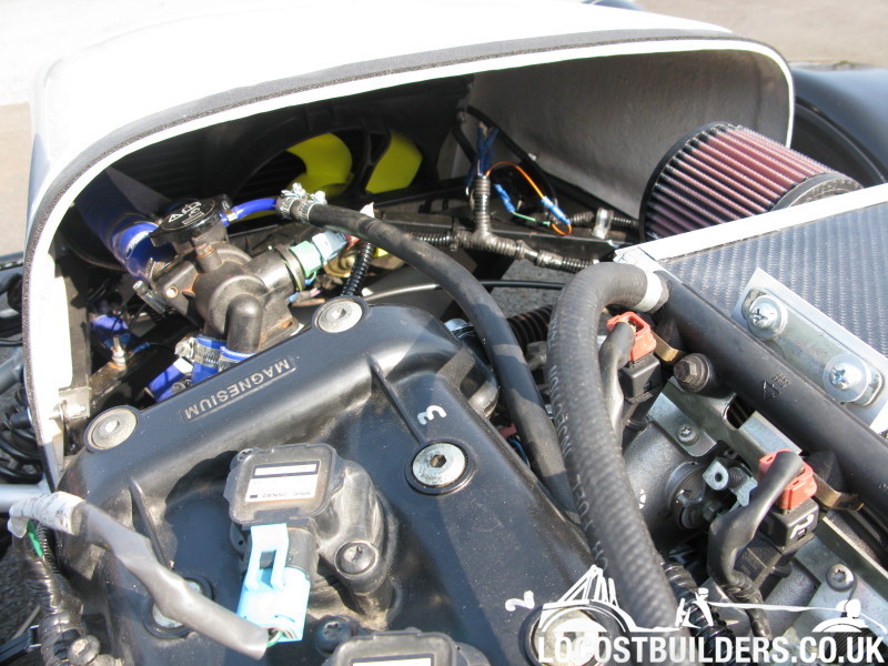

can i see two small holes in the upper wishbone? (third piccy)
if so I may be inclined to question the tubes structural strength?
just a thought
[Edited on 21/3/09 by nib1980]
twybrow - 21/3/09 at 07:42 PM
This is how I received them (part built)... I guess its for attaching wiring to for wing mounted lights. I guess I could weld up the holes...?
Would I be right in assuming they are also at the point of the least bending stress, as the top and bottom of the tube would take the tension/compression?

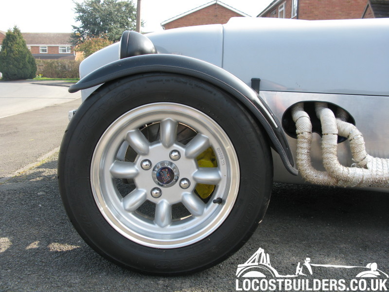

looks like you have a split rubber boot on one of the steering ball joints
and will second covering up the spring adjuster nuts
Eyes like the proverbial outside toilet rat!
omega0684 - 21/3/09 at 08:47 PM
i spotted the split rubber on the lower ball joint, apparenetly 'there supposed to be like that'

The TRE are brand new, and appear ot have four small splits, equally spaced around the boot. I can only assume they are supposed to be there.

splits = mot and sva fail
twybrow - 21/3/09 at 10:08 PM
Really? Dammit! I have a reciept for these as new, and the splits are manufactured in there - not due to perishing!
Next question then, where is the quickest and fastest place to get new TREs?
twybrow - 21/3/09 at 10:23 PM
I've just been out for another look at these TREs. It seems on one side, it is perfect, no splits. The other side, has 4 evenly spaced splits in the rubber. I cant beleive I have never notced the difference!
As such, does anyone have an Escort TRE kicking about in exchange for beer tokens?
