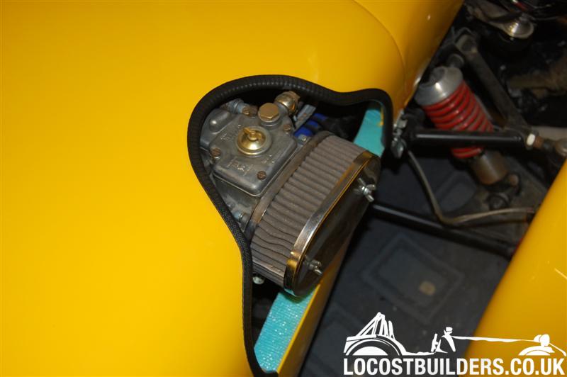

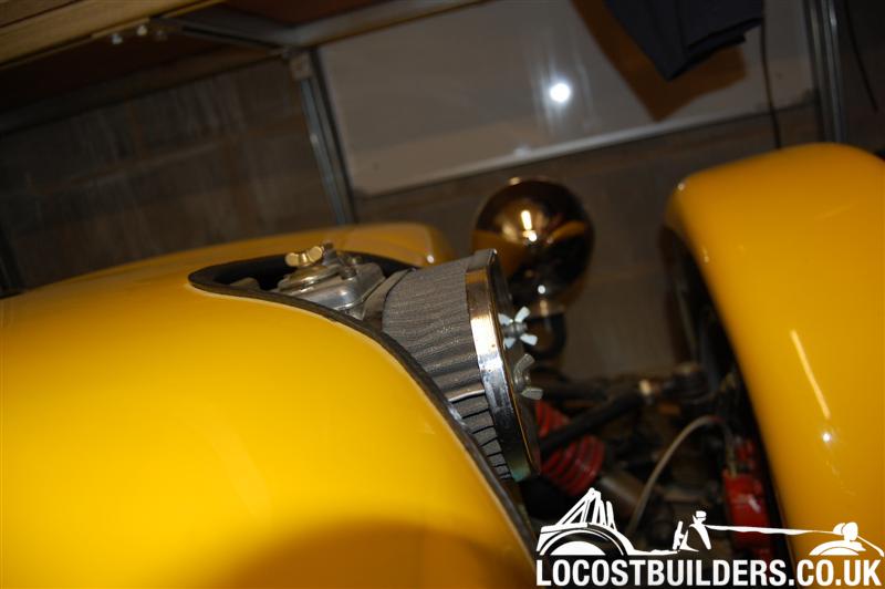

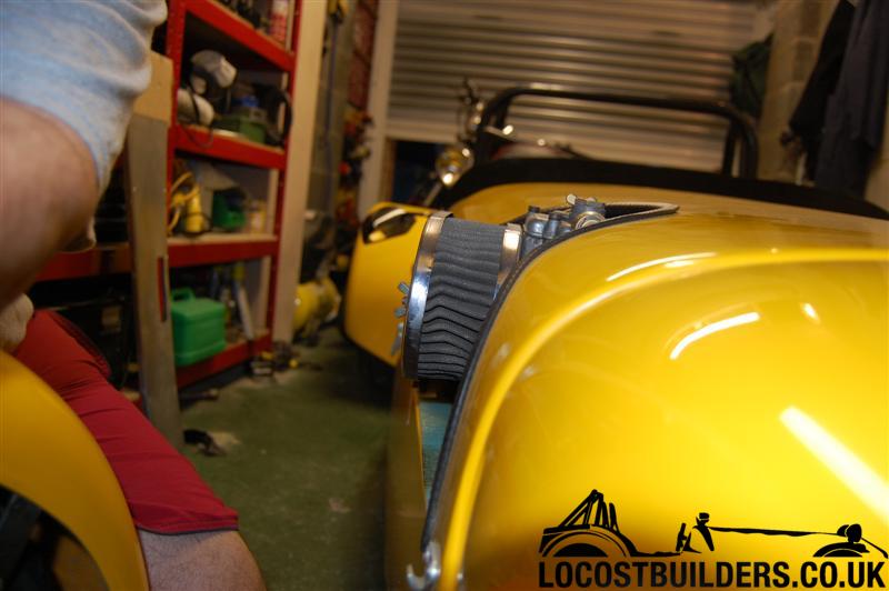

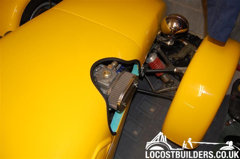

got s problem with a stuck out weber, any (Sensible) ideas on how to make this pass the exterior projection checks ??

hi ray, can you put some wire mesh over it. so its like a cage.
[Edited on 21/3/10 by dunk3]
The outside of the filter should pass...
You need to replace the wingnuts with flush dome heads though.... then just cable tie a piece of rubber over the top of the carb body to cover up the
bolt heads on top...
bits of rubber cable tied on are no longer acceptable. its in black and white in the manual.
chicken wire bonded on to the back of the bonnet or find a lower profile filter if such a thing exists.
I would suggest getting a fibreglass kit and making a custom scoop? Would be a good skill to learn too
