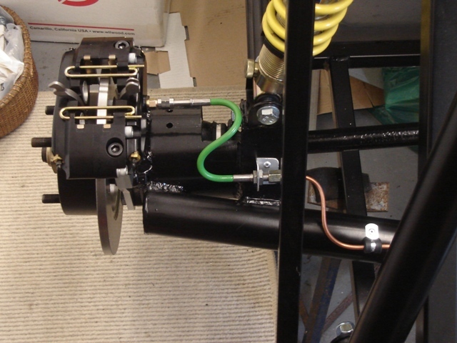

Had the re-test today at Birmingham and failed again!
Everything is OK apart from the Handbrake efficiency. Even with an extra linkage I still can't get them to the required 18%.
Tester was great and gave me some time to adjust them.
Going to swap for Sierra units to get it through.
Anybody know where I can get caliper adaptors from?
Bad luck. What do you mean by caliper adapters?
Give us a clue, what are these crap calipers you have?
Willwoods?
Yes, the Wilwoods. Just couldn't make the 18%.
The caliper adaptors are the plates that convert Sierra drum hubs to accept Sierra Calipers.
