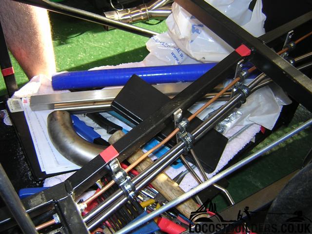

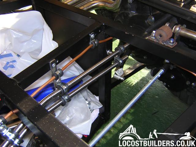

spen today clipping fuel and brake lines down the tunnel, look OK for SVA????

Nice neat job from what I can see
rusty nuts - 19/8/06 at 05:27 PM
Looks neat, just hope you never have to remove them . Might be a bit akward drilling out all the rivets with everything in place? Whats the threaded rod for ?

cheers,
the pipes are fixed to the brackets using dome head screws(does look like rivets in the picture though) so removing them shouldn't be a proble,hopefully won;t need to though!!.
the threade rod is part of my gear linkage, will be changed for something else once i've proved it works

omega 24 v6 - 19/8/06 at 06:18 PM
Looks neat and tidy mate. Only problem I can see is that in the distant future the alloy/steel mix (it looks like that but maybe it's not) could corrode and fall of. Not something to be relished in the prop area
02GF74 - 19/8/06 at 08:17 PM
if I was Mr SVA I would not be happy about the long dangly brakets - I can only see they are fixed at the chassis and then hang down - vibrations may affect the brake pipes.
If you push on the botton of the dangly bracket, does it move at all?
omega0684 - 20/8/06 at 10:29 AM
i thought that fuel lines had to go on one side of the tunnel and brake and wiring loom on the other side
rusty nuts - 20/8/06 at 12:17 PM
Tell that to some of the major car manufacturers . Then again Ford Focus fuel pipe clips are a lot further apart than our cars have to have them
02GF74 - 20/8/06 at 06:51 PM
dunno but it would make sense to keep electric (source of a flame) away from fuel and brake (stuff that can burn)
