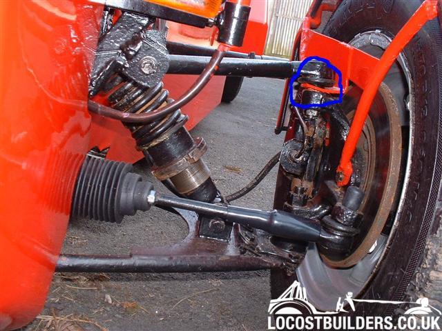

Avoneer
| posted on 19/3/09 at 07:03 PM |
This would concern me:
jacko
| posted on 19/3/09 at 07:16 PM |
Well spotted that dose not look good

Dangle_kt
| posted on 20/3/09 at 08:26 PM |
Im not sure if it is the angle of the photo, but this doesn;t look very weel welded. I cant quite figure out what is going on with the steel under the
mount, not to mention the amount of weld on the mount itself.
Did you weld the chassis yourself? Are you confident in it? Not trying to be a killjoy, but the if the inspector spots something he doesn;t like the
look of, he will cast a very close eye over all of the rest of the welds, which might not be very good.
Hopefully its just the angle of the pic and its all good.
At the end of the day its your bum in the seat if it all goes wrong at 50mph + so it really is best to be sure its right.
