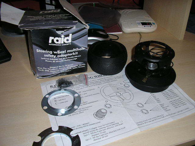

| posted on 18/12/08 at 08:14 PM |
colapsable boss...
fits sierra column to momo raid dino and many other types of wheel but dont think it fits Mountney
not 100% perfectly square ...
free to good home...( first dibs peterparsons if its any good to you )
cant post until next Tuesday.
Paul
Paul (Notts)
| posted on 18/12/08 at 08:15 PM |
top not 100% square with coloumn

peterparsons
| posted on 19/12/08 at 07:55 AM |
Yes please Paul. U2U sent
