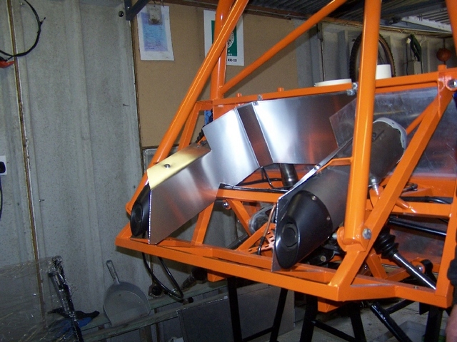

I have my exhaust inside the vehicle, manifold inside the engine bay and the system down the tunnel, around the diff and into a link pipe for the 2 R1
silencers out of the back panel.
bigrich
| posted on 7/1/09 at 12:12 PM |
and with the rear panel on
Daddylonglegs
| posted on 7/1/09 at 02:11 PM |
Bet that keeps U nice and warm in the cooler months

Just a word of warning - the original Fury Menace had a rear exit exhaust like this.
When it went off-track, the bodywork touched the exhaust outlet and ignited....
