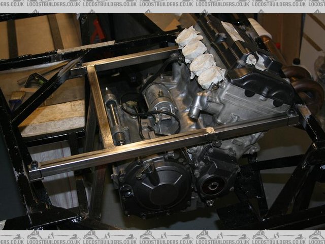

Engine is now in position, cradle is 80% complete:
![](/galpreviews/IMG_3400_20.jpg) ![Engine In!](/gallery/IMG_3400_20.jpg) Engine In!
![](/galpreviews/IMG_3406_20.jpg) ![engine cradle 1](/gallery/IMG_3406_20.jpg) engine cradle 1
I've done the cradle as a single-peice so the whole thing can be taken out from the top by undoing 6 M10's.
![](/galpreviews/IMG_3399_20.jpg) ![sump & filter clearance](/gallery/IMG_3399_20.jpg) sump & filter clearance
Only just got it to fit! should just about have enough ground clearance, thanks to Andrew C for the advice ...although those ally lugs might have to
come off and a sumpsheild be knocked up???

Have you given the engine any support from lower down the chassis bottom coming up.
andrew.carwithen
posted on 24/2/09 at 09:43 PM |
Looking good, mate. I reckon you'll have an inch more ground clearance than mine.
Have you fitted a baffle plate to prevent oil surge?
I would remove the fins from the bottom of the sump. I did and the sump still brushed the edge of the trailer when loading car for SVA !
I like the 'zorst manifold - is it from a Westie megablade?
Andy.

I wouldn't remove the fins. I've got them on my ST1100 and I use them to decide when I need to raise the ride height a bit ![](/images//smilies/smile.gif)

![](/galpreviews/IMG_3394_20.jpg) ![engine cradle 2](/gallery/IMG_3394_20.jpg) engine cradle 2
I havent finished it off yet but both lower mounts will come off these two angled struts, negating the need for a lower cradle section. The struts
also support the crossbar of the upper cradle it is also stronger, stiffer and lighter than having two sections.
AC: Yeah the whole package is of Megablade origin, so its got uprated clutch, baffles, prop adaptor and ss exhaust system.
Ben: fair comment! noted
