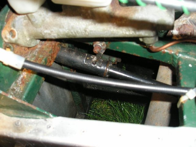

I have a cortina column that has what looks like a big spring at the top of it and when you push the steering wheel it compresses, is this deemed to
colapsable? even though it springs back?
On inspection of the sierra one i have it looks like once its been deformed it stays deformed.
P.S i think its a cortina one? maybe Escort? can any one id it?
[img][/img]

theconrodkid
| posted on 29/2/04 at 03:02 PM |
that spring only holds everything tight,has it got a convaluted outer section and is the shaft triangular?if so its a collapser

locoboy
| posted on 29/2/04 at 04:12 PM |
Oh Balls,
thought it was too good to be true
problem is its already wired to the column switches for this column!
So the consensus is that it must have a collapsable section then?
Locoboy
Jon Ison
| posted on 29/2/04 at 04:22 PM |
it still should be unless you have shortened it in some way, is the end of the shaft triangular and do you have a convaluted section along its length
?? take n post a pic of other end for us to see.........

locoboy
| posted on 29/2/04 at 10:49 PM |
Thanks for the interest guys, and a good thread link to Jon,
i shall take a piccy of the other end in the morning, Im pretty sure it aint triangular and im also pretty sure there is no consertina (sp) type
affair, its a tube about 30mm diameter all the way down to where a smaller diameter tube pops out the end to meet with a splined uj,
All from memory might i add, will confirm with piccy in the morning.
Locoboy
locoboy
| posted on 29/2/04 at 10:55 PM |
braved the frost and just too these, have i got the rarest column going or what? ohhh er missus!
  column UJ
[Edited on 29/2/04 by colmaccoll]
  end column
Locoboy

theconrodkid
| posted on 2/3/04 at 01:56 PM |
got me there,top looks like escort,dont recognise the bit U/J down tho,if its escort it wont be colapsing
