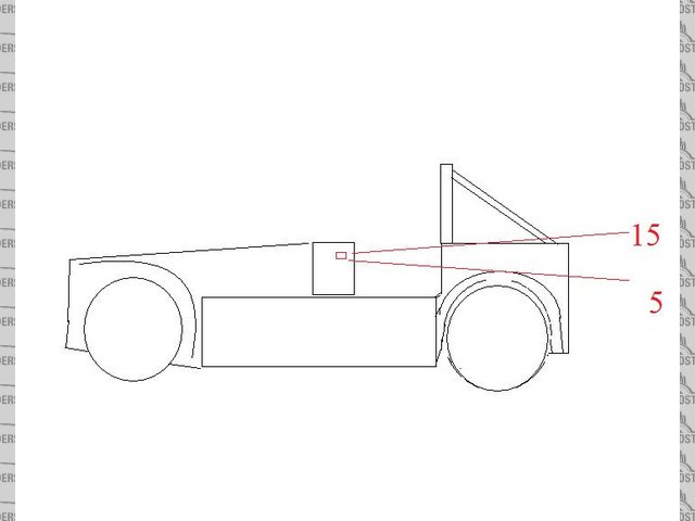

| posted on 3/3/10 at 10:47 PM |
From the rear 5 and 60 degrees as shown they also have to be seen 5 degrees below the horizontal line and 15 degrees above the horizontal line.
I failed IVA on that.
Adrian

Nash
| posted on 3/3/10 at 11:01 PM |
Adrian
So Adrian do you mean this?
  Side Repeater sidviewing angle
again sorry for the crude drawing (its locost )
........Neil
Build It, Buy It, Drive It:
Southern Kit Car Club
gdp66
| posted on 4/3/10 at 12:01 AM |
yes , i think they would pass if visible as shown
