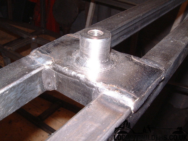

posted on 2/7/10 at 09:33 PM Reply With Quote
How ive done mine but there are other ways.
pic

bigpig
posted on 3/7/10 at 11:10 AM Reply With Quote
I would suspect they may consider them not being strong. I think I'd be considering if they would twist the bar in an impact.
MK weld them on the back pf the bar and put a triangulation piece either side to provide extra strength.
