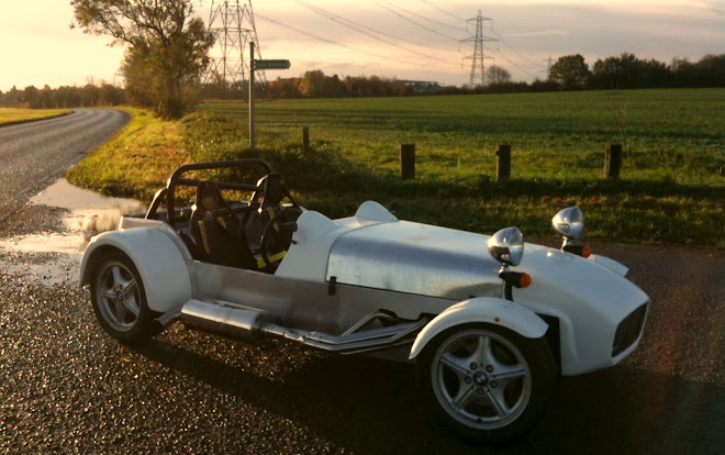

rodgling
| posted on 20/2/11 at 11:32 AM |
They were happy with mine in this position when I did my IVA (Norwich) - didn't even mention them. Pic:

rodgling
| posted on 16/3/11 at 03:51 PM |
oh, sorry, I think I misread your question... they were fine with the *repeaters* as in the photo, but they did not accept the main indicators below
the headlights (too far from the outside edge of the car by about 18 mm). I've since replaced them with indicators on stalks coming out of the
nose cone which I hope will satisfy them.
