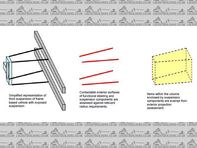

There is indeed an exmpt zone within the theortical wishbone 'box'.
  IVAWishboneExemptionArea
Mistral Motorsport
hellblue
| posted on 30/9/12 at 12:02 PM |
As above, but yes, as you say you can mount a light or use another item like the stalk to stop another item being testable as it is now no longer
contactable

Theres a diagram similair to that in the IVA manual that ive been studying.

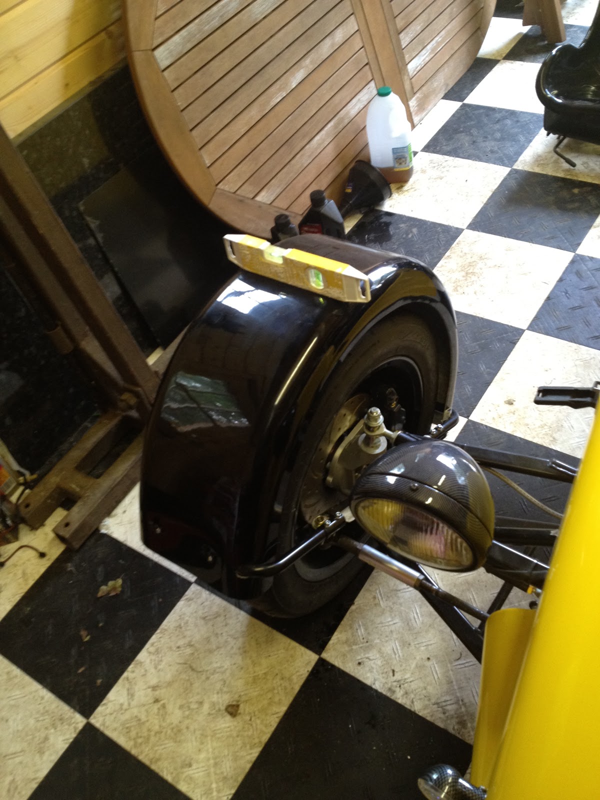

When you say you extended them for iva is that because it’s a requirement, or just to make it easier to pass?
Mine are currently just bolted to the nose cone – do I need to change that in order to pass IVA?
heres a pic I have with me today, the indicator is just visble in the bottom right hand corner
link to pic Link
Thanks in advance

The reason you see them on no many 7s is nothing to do with exterior projections, Its beacuse the indicator needs to be within 400mm of the side of
the car (at the widest point, usually the back).
So andrew, yours will defo fail on not being far enough out.
If you dont like the look of them, put them on for IVA then remove them, it wont need the extenders to pass the MOT so long as they work and its
fairly obvious which is left and which is right 1

It's a requirement for IVA but not mot. They have to be within 400mm of the widest point of the car. Section 23 in the manual.
My extensions fell off on the way home from iva miraculously.

andrew_s
| posted on 1/10/12 at 01:46 PM |
thanks for that, if I add mirrrors with indicators will that still mean i need to extend the front ones ?
Just planning the final phases and purchases to get it through?
will dig the manual out tonight

Mirrors would need to be quite high so you can keep the 45degree horizontal and 5degree vertial sightlines for the indicator on the opposite side from
where you are standing. (ie the bonnet/skuttle may block the left hand indicator when standing on the right and vice versa)
Make sure you use the latest manual - http://www.businesslink.gov.uk/Transport_files/IVA_M1_Inspection_Manual_1.pdf

I have mainly extended them to put the 2 chassis "ears" in the exempt area behind the extensions, although I am now not sure if this
applies to IVA, as I think the area can be checked from the rear, in SVA it couldn't. If that makes sense.
