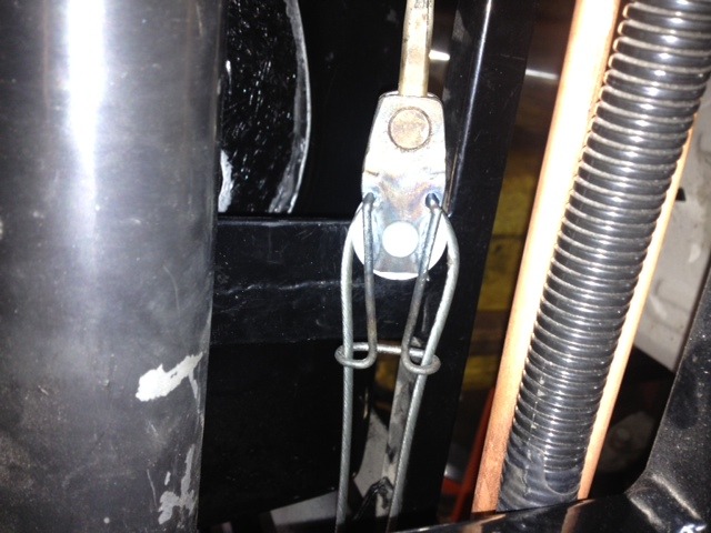

Rogthebandit
| posted on 24/12/12 at 01:08 PM |
hi
i have managed to upload photos at last ;-).
do you recon the mech is to close to the chassis?
  handbrake mech 1
  handbrake mech 2
[Edited on 24/12/12 by Rogthebandit]
britishtrident
| posted on 24/12/12 at 02:20 PM |
Brake cable would not concern me ....
[Edited on 24/12/12 by britishtrident]
[/I]
Rogthebandit
| posted on 26/12/12 at 10:03 AM |
Cheers for the feedback mate. I think it looks ok, just wasn't sure if mr iva says it can be pushed over with ease to touch the chassis. I recon
I will go for it anyway. Thanks Rog
