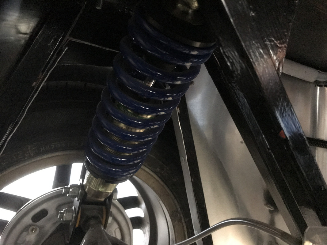

My rear lights are only approx 330mm off the ground (need to be 350mm). Do you think ill be able to raise the back end by adjusting the coil overs?

Yes, that is what they are for. Just use a C spanner on the adjuster nut.
Raising rear by 20mm should be achievable for IVA test.

Thanks both, i’ve got c-spanners and will screw the spring collars up and will stick some more air in the tyres.
