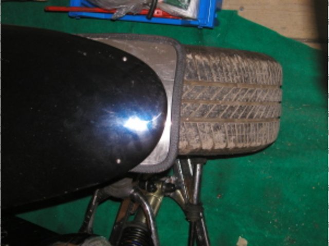

front end sva c0ck up or not ?
so have i put them in the wrong place or not, is this sva friendly ?

I've put mine in a similar position so if youve cocked up then so have I!

Yup wing needs to cover the wheel as shown in pic and also if looking from above needs to cover wheel too (not tyre)

rim edge vertical has to be the leading edge mark

sorry they must cover the rim at the front and be no higher then the centre of the wheel at the back Graham

this is how they came as i bought it part built, or part cocked up.
i had an idea it wasnt right.
many thanks guys
looks like i need smaller wheels lol

or just fit some temp extensions till post sva

Another option might be to fit 13" wheels for the SVA.

surely with 13" wheels it would be too far down at the back i.e. more than halfway?

I just used carpet glued to the back of my cycle wings - to act as mud flaps, and also to make the rear of the wheel rim get covered by the arch.
no SVA problems with mr sva that way.

i might just take them off and move them forward, there glued on so shouldnt make a mess
You might not believe this but 13" wheels will have the centre in the same place as a 15", so if it's below the centre of a
15" it will be below the centre of a 13" .
It's supposed to be, it just shouldn't be higher than the centre at the rear.
that is the best way.

I watched the SVA man check my wheels - rough summary is:
1. Drop a line from the front of the mudguard - must be in front of the wheel rim.
2. Drop a line from the back of the mudguard - must clear the wheel & tyre completely.
3. Drop a line from the outer side of the mudguard - must clear the wheel rim.
He used more technology - number 3 is physically impossible because of the tyre - but it explains the principle. He used a big set-square and a
ruler, on a flat floor.
