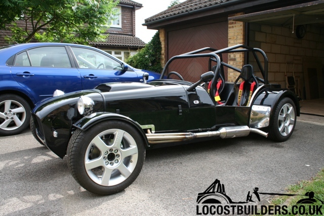

Problem is not so much that I can't see past rear my rear wings etc., it is that they won't adjust such that I can see anything to the
rear of the car. That is unless I pivot them forwards, which exposes the base plate, or have them at a strange angle such that they are at about 45
degrees to the ground.

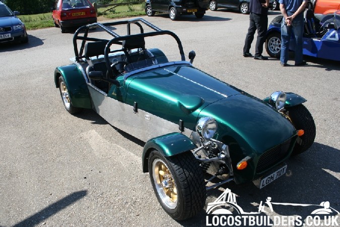

ned
| posted on 12/4/06 at 12:07 PM |
Shortie has the same mirrors and his are fitted at an angle, as recommended by mac1 iirc.
http://www.locostbuilders.co.uk/upload/July02_2005__005.jpg
i *think fozzie has the same ones again
http://www.locostbuilders.co.uk/upload/Fozzmobile%20august05b.JPG
