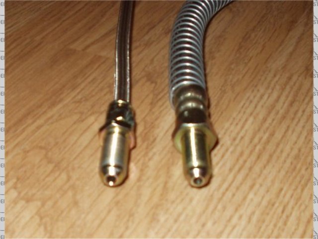

Are these brake pipe ends ok for SVA?
I got all confused by the recent thread on brake pipes for SVA, so I decided to take a picture.
I know I'll have to cover the braided bit, but I'm not sure if the ends are OK.
Could someone let me know please?

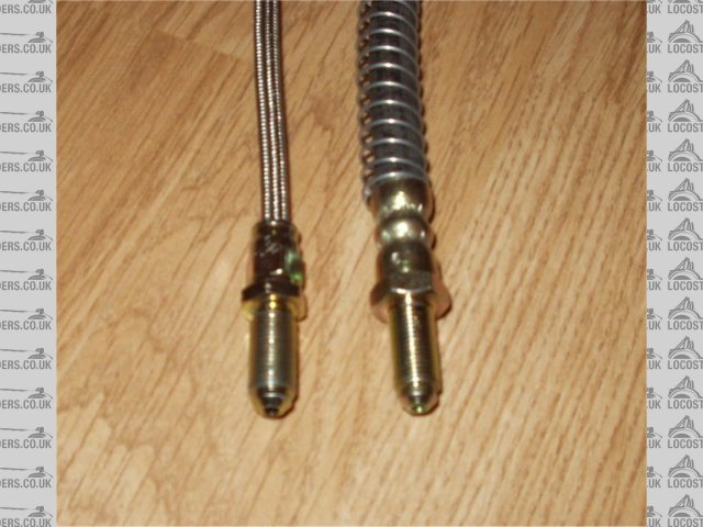

| posted on 20/4/03 at 07:22 PM |
And another picture

Viper
| posted on 20/4/03 at 07:42 PM |
Going by what it says in the sva book i would say no they are not as the type you have there have seperate olives inside...
if it helps i have a pic of a compliant braided hose in my archive.

I called the SVA helpline on this issue last week. They at first quoted the SVA book answer, but looked into the issue for me. They then said there
was an update memo sent out saying that if the pipe had a seperate nut and inner tube support sleeve they would be OK. The advice was to take some
evidence that this was what had been fitted to the test. I will take a ride down to my local testing station and see what they say, will post reply.

Viper
| posted on 22/4/03 at 08:31 AM |
standard rubberhoses wil have crimped ends so they are sva friendly, the type in your pics do have the inner tube doodad.
Northy
| posted on 22/4/03 at 11:33 AM |
Cheers Viper,
So thet ARE ok then? Which bit is the special doodad bit they are looking for?
If I got some extra ends and took them with me to SVA, do you think that would be good enough?
Viper
| posted on 22/4/03 at 12:23 PM |
I don't know if they will accept that or not, i am only going by what is printed in my SVA manuel, i have been fortunate in being donated a set
off a TVR which has to go through a similar process to the SVA being as they are a small manufacturer.
your pipes ..the fitting on the end of the pipe has a tube, if you like, that pokes up inside the plastic inner part of the hose you will have an
olive that goes on the outside of the plastic and under the braid then a nut that squashes the olive onto yhe plastic tube in turn clamping the tube i
first mentioned creating a bloody good seal...
hope that explains it and if what zetec says is right then you should have no problem, all the braided BRAKE hoses are done this way, i think what the
SVA mean is that you cant use braided hose that uses a cover with a jubilee type clip inside as these won't take the required pressure (the kind
used for low pressure fuel lines etc)
does that help or have just realy upset the apple cart?

bob
| posted on 1/5/03 at 03:36 PM |
GOOD NEWS
Took the spare pipe i have (same as northy's pic)to the Yeading SVA test centre.
The guy i saw was really helpfull and said the pipe was OK,he had a good look at the pipe and asked how the ends were fitted to the caliper and brake
pipe.
I told him one end screws direct to the caliper and the other with pipe nut to a double flare on brake pipe run,this he said was acceptable.
He did go on to say that the connection he didnt want was the pipe screwed into the caliper and sealed by the use of an olive,but that it would also
be imposible to tell without dismantling the pipe connection.(which they wouldnt do)
He also said dont bother bringing any evidence of how the pipe was made up as the paperwork might not correspond to the fitted part anyway(good point
i thought).He said he wouldnt bother reading it anyway.

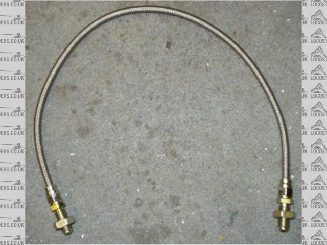

Northy
| posted on 1/5/03 at 08:35 PM |
My girlfriend phoned Beverley SVA (our local SVA station) today, and he said if they were made with seperate olives they would fail. BUT I got some
rubber hoses at the weekend (see pictures below) and the ends look the same (the threaded bit). Bob do I take it from your post that olives INSIDE the
end fitting are fine? Can you really get them with an olive on the end? Help I'm still confused!

Viper
| posted on 1/5/03 at 08:51 PM |
Graham
your braided hoses have an Olive inside..
you can unscrew the end (with a pair of spanners) and you will see what i mean. your rubber hose in the pic has a swaged end or crimped so you
can't take it apart. so the SVA know it has not been tampered with. if i was you i would put the rubber ones on till you have passed at least
you know that won't be a fail point...
Northy
| posted on 1/5/03 at 09:09 PM |
Viper,
I was going to do that, but I couldn't get any long enough for the front. The guy at the local motor factors spent ages looking through his book
and stock!
Unless anyone knows some that might be long enough (Cortina calipers).
