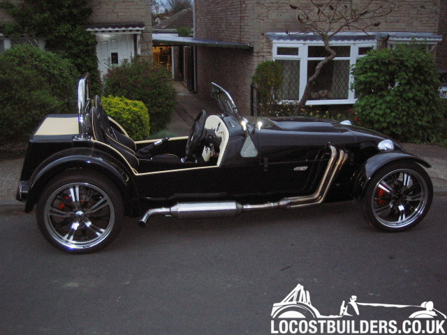

Well Good evening all.
I'm now less than a Week away from the test at Beverley (wed 25th), and thought that I ought to do myself a favour and post a few pics for you
guys to have a perouse (think is spelt correctly!) over but then changed my mind and thought of a better idea, Post a boat load of pics for you guys
to look at and hopefully pic up on the things that I have missed.
Stuff that I still know that I need to do are.........

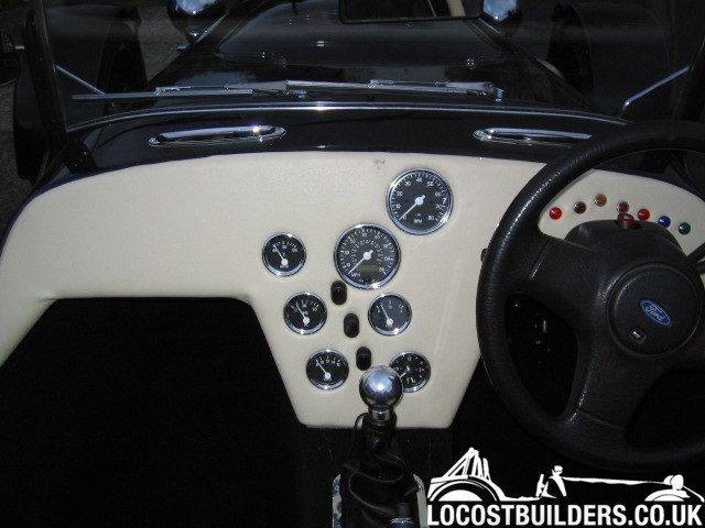

Label up the dash,
cover under dash,

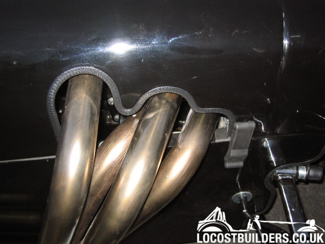

nut covers and trim on zorst can bracket,
cableties on the front indicator extensions

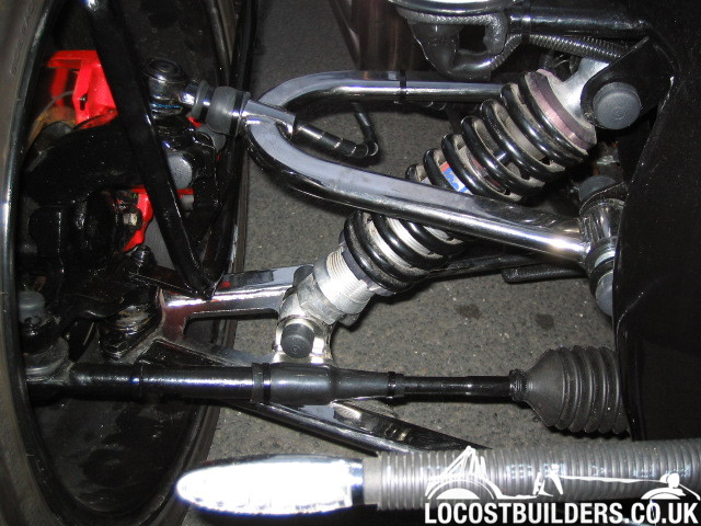

and also cover the top and bottom of front springs but i'm looking for sugestions on what to use on this.
Here are the pics......
  Back end
Do we think this needs a tweek? i'm not sure? FOG btw is in the middle of the far light!
  A veiw
  Front end
  O/S suspension
  N/S suspension
And Finaly!
Thanks For Looking, Any comments are a help.
Thanks a lot for any advice.
john.

Think bike rubber inner tube is ok around the coilovers.

Not sure about this one but what about the brake lines cable tied to the wishbones?
May be ok but worth checking.

As above, not sure about front flexi tied to wishbone.
Re, springs, this is what we did.
  Front suspension
Simon

The cable ties on the wishbones can come off, they are just on for the sake of it, they'll still clear everything without.
As for the shox ideas, Thanks.

really nice build, i like the dash layout.
I used a large gator cut up for the top and bottom of the shocks and cable tied on, i bet people are sick of this pic but it does help.

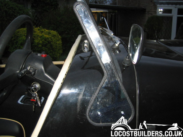

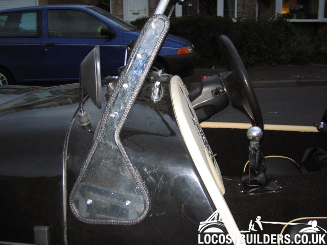

How good is your wiper sweep?
It looks like they might struggle to clear the far right of the screen infront of the driver?

as above cheap driveshaft gaitors over coilovers

also wrap a bike inertube around the big nut where you adjust the coil over springs

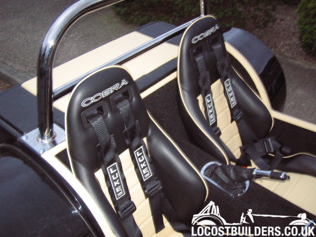

where the seat belts bolt onto the chassis behind the seats needs covering as its a radius

The wipers when fully over, touch the edge of the screen at about the same place as the top of the support bracket on the drivers side, I could get it
to go a little further down with a bit of cutting and bending of the arms and blades but I thought it would be ok as is, what are oppinions of this?
The cable tie is now off and the shockers are on tommorow afternoons list.

For the harness mounts do you mean the actual nuts need covers or somthing else as they have covers already but you can't see in the pic.

Front flexi zip tied to top wishbone - exactly what I did for my SVA & not a problem, though I must say your ziptie looks more like an
afterthought than mine! otherwise the car looks fantastic - good luck

I used RC car tyres to cover top & bottom spring seats - cost me a tenner for 4 (they seem to have fallen off since......) note the slicks cost 4
times as much, if it's only for SVA use the cheaper 'rain' tyres
Bob

Danozeman
| posted on 20/4/07 at 05:46 AM |
Very nice car that mate. U dont see many with cream dash etc. Good luck with sva..
Oh what about the front brake pipes with the curl in? Are they aloud, looks like it puts extra strain on the pipe.
Are there warning symbols on your dash lights?? Cant quite see in the piccie.

Im also not sure about the curly brake pipe. Other than that Great work!
