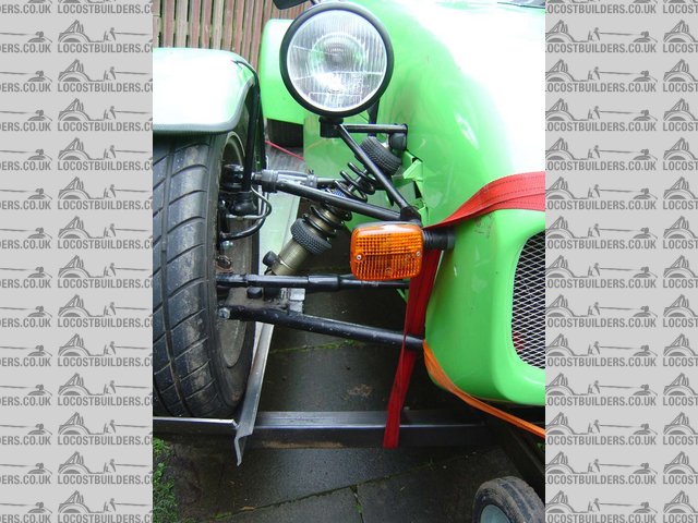

Thanks for the replys to date, keep them coming!
I've now got me a new steering wheel for the SVA, pick attached, I found the old sierra wheel and just could't bring myself to fit it!
Regarding the clocks, yes I had thought similar and I've made up a cover.
The headlight bar has some trim on the edges, but I'll have another look.
Bottom of the shoxs, yes I feel a bike innertube may require being sacrificed for the greater good!
Finally the collector, I had a look, the seams are smooth, but I may invest in some exhaust wrap to be sure.
Once again thanks for the feedback, I'll give an update when I go for the SVA.
Ian
Bob C
| posted on 5/5/08 at 10:26 AM |
emissions, self centring ;^)
looks fantastic!
For top & bottom of shocks I used radio controlled model car tyres. Slicks look pukka but cost up to 4 times as much as ones with tread.
