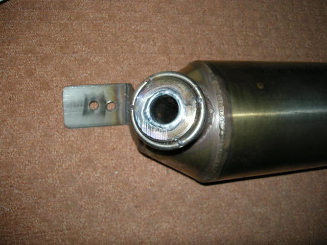

EXHAUST IS TOO LOUD
Following my SVA test score of 106db. I asked Martin at MK to mod the exhaust. He has put in a hockey stick pipe at the outlet with a smaller
end.
Is there any other trick to make it less loud. I have heard that stuffing it with wire wool may work
Any suggestions?
paulmw
| posted on 5/5/08 at 12:56 PM |
End
jos
| posted on 5/5/08 at 12:57 PM |
sacraficial sock - same job as wire wool
RazMan
| posted on 5/5/08 at 02:44 PM |
Changing the silencer wadding for something else might work, although I would say that E-Glass is the proper stuff and will last for ages - wire woll
tends to disintegrate and get louder as well.
Raz
