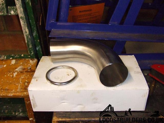

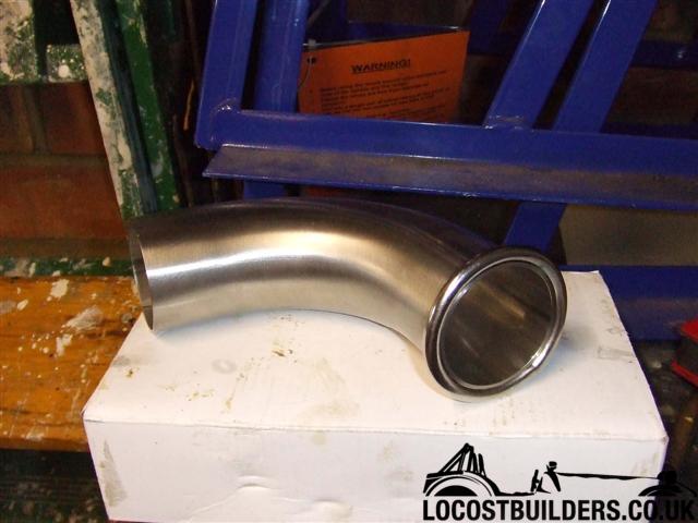

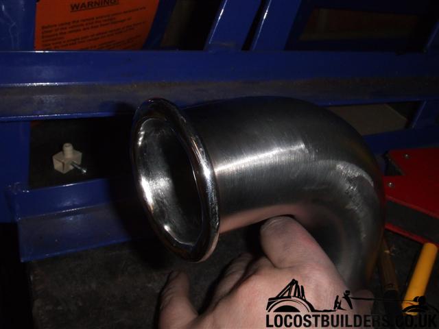

RichieW
posted on 7/7/08 at 10:27 PM Reply With Quote
What size exit is it? You can buy stainless steel rings from chandlers online in various diameters.
This is what I did with mine.
2inch 90 degree stainless bend with a 6mm thick 2inch diameter stainless ring.
They fit together very well on their own.
I fully welded round the join. I wont show you a pic of the weld as it was fairly appalling. First time with stainless and pure argon and I can only weld in straight or wavey lines and not circles .
I then ground down the edges and polished up. Since this pic I have another stab at polishing and making the inside edge a little more circular. Stainless is so hard though to polish and shape. Ally is much easier.
