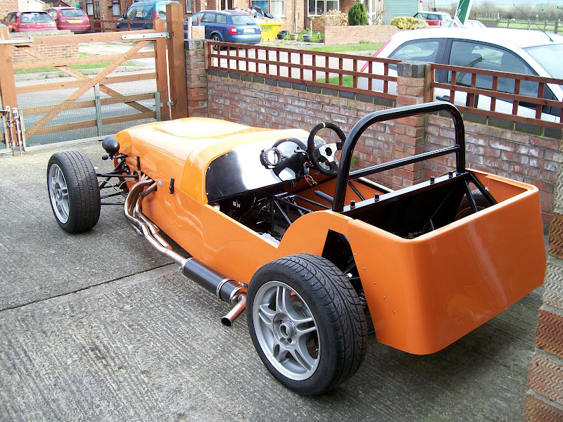

Ok that didn't work! here's another better pic!
dan__wright
posted on 5/9/08 at 01:22 PM Reply With Quote
i don't think it would, the mnr silencer is very long, my manifold is very long and there isnt huge room for the silencer.
FREE THE ROADSTER ONE…!!
Johneturbo
posted on 5/9/08 at 01:40 PM Reply With Quote
ahh point taken Dan. it looked like you had a long link pipe in your avatar pic.
how did you get the cat to fit for the sva?
