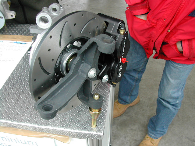

MNR were working on one, I took this pic at Total Kit car Live in 06???

liam pictures the raceleda one, which i believe MNR have now stopped making, though i may be wrong.
that picture isnt the raceleda one, the raceleda one is a one piece casting that one is fabricated
