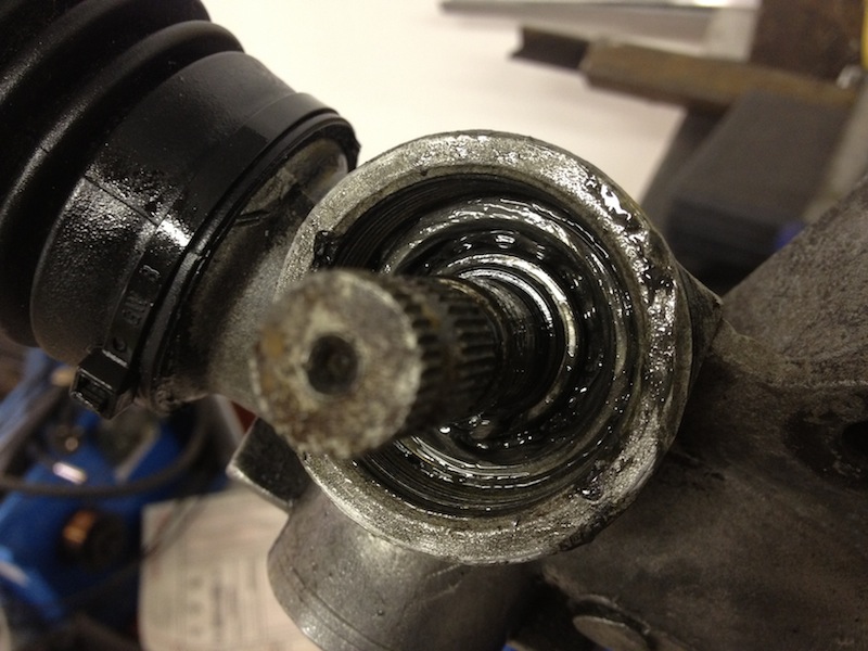

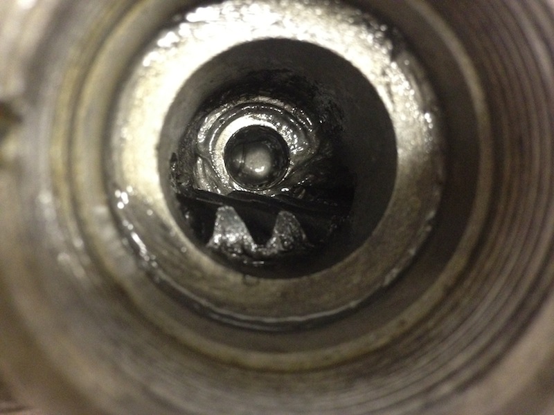

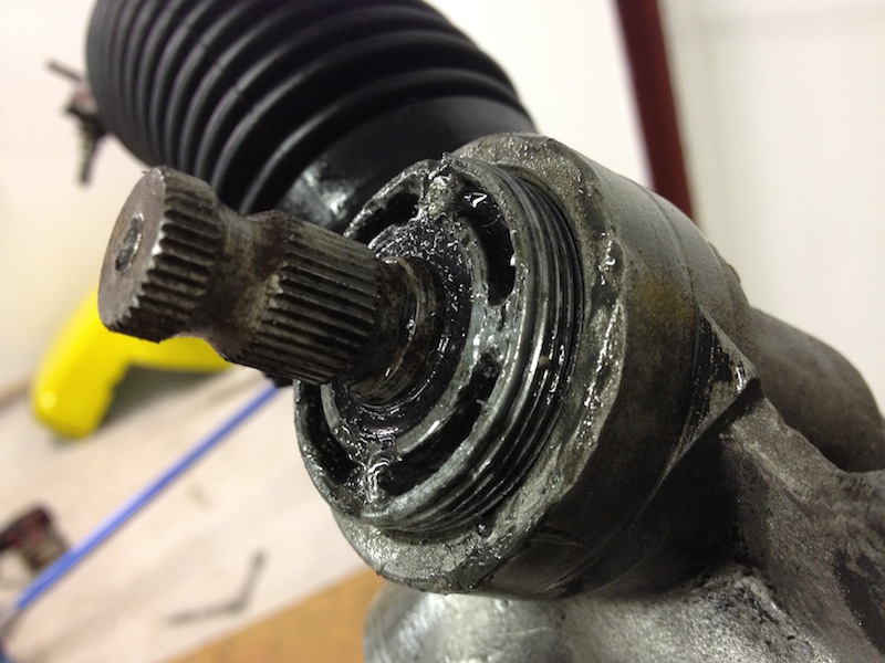

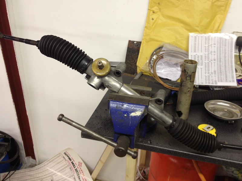

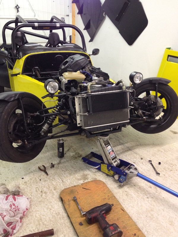

Surprise surprise its back in bits again...
Just nipped down the garage to have a look at the pinion adjustment nut
Whipped the rack off
Bit of a struggle, but managed to undo the pinion adjustment nut
Bearing inside holds the pinion centralised, as the slipper spring holds the tension down onto the rack

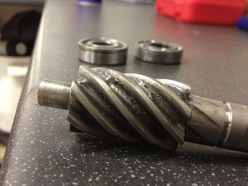

No real signs of wear on the teeth of the pinion itself
Nor the rack innards...
So built it all back up again, and its made sod all difference - still loads of play, but only when there is load on it, ie: the car down on the floor... when in the air, it has no play
I'm thinking the bearing may be shot and needs replacing, as the pinion moves in and out slightly when you go lock to lock, which I'm pretty sure shouldn't happen...

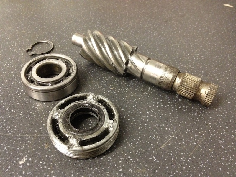

Problem solved!
Here's the breakdown, kinda difficult to explain.
Removed the rack again, removed the pinion adjuster sleeve, and the circlip and the bearing.
Then removed the plastic 21mm slipper nut, spring and slipper itself.
Not much wear on the Quaife item itself, but all the movement was from in between the bearing and the circlip. I thought when you tighten the pinion adjustment sleeve up that it'd clamp the bearing nice and tight, it doesn't.
Two ways to cure would be to get a thicker circlip, which would eliminate the play, but it already fills the groove nicely.
So we replaced the bearing just because we could, then put a shim in between the bearing and the circlip which removed all lateral movement.
We followed the Haynes manual in setting it up, but with it being shortened and new innards we took the process principle, but adjusted it by feel.
We put the rack in the car, and put all the steering back on the could adjust the 21mm slipper plug in situ whilst wobbling the steering wheel so there was next to no movement.
Obviously the tighter you go the more wear on the pinion and rack you will create, it also leads to a heavy steering car. So feels smoother with it loose, and less gratey but then there is movement.
I've jeopardised the smoothness of the lock to lock transition for a right rack, everyone loves a tight rack, right?
