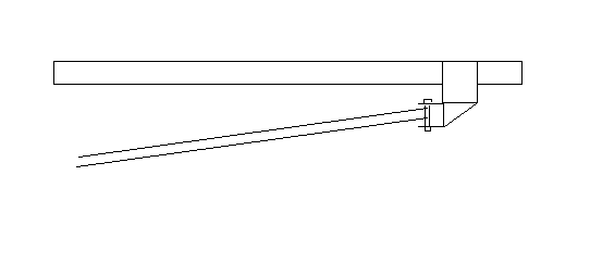

Thanks Mike, you have managed to draw this as I had tried to describe in the second posting.
Pat was refering (in your quote) to the book (Ron Chapmans), showing the correct positioning of bracket and rose joint.

I like the method illustrated in MikeRJ's sketch.
Rod ends can be made to operate at high angles 90 degrees to the bore's axis (I get 46 degrees out of them for steering), but it's much
simpler doing it the way that's been suggested.
Whilst I would never suggest the IsonBlade performs less than satisfactorily, mounting a rod end, on a lengthy spigot, on a thin-ish bit of sheet
metal, and in single shear, wouldn't be my way of guaranteeing a sound night's sleep.

and cheers Mike for drawing what I said in the third post...memo to self......I must brush up on me computer drawing
skills!
Sorry foggie, takes a bit for me to come round to a better way of thinking!
So if I move my bracket in towards the centre of the car to gusset the back of it (like Mike's pic), I'll still have a problem with the
nut.
Can I still weld a nut to the inside of the bracket as per my latest pic and gusset the back?

If it was my car I would actually use the first method suggested with the rod end horizontal. This gives the better load paths, is easier to make and
allows you to have a panhard rod as long as possible.
However you must check you do not run out of travel on the joint, ie it does not bind.
Mounting the SRE on a post in single shear ia a bad idea.
Mounting the SRE as in the last picture is a good idea, it is just more complicated to make.
Sperical bearings can operate in any orientation, in certain orientations you have less movement.
Check out most top racing cars that use spherical bearings (such as a Gould hillclimber, you will not find anything bad about this car) and the
sphericals are mounted horizontal at the chassis end.
John

Mikes drawing is spot on, the bracket has been made, you just have to turn it as described, and you will have to do a strengthening plate/gusset.
Uncle Rons book is not the best example of how to do things neatly, but the positioning is right.

if i were to do it petes way, i would use a piece of 50x50x3mm box section, cut to a diagonal and with a 3mm plate on the back. This would ensure that
the bracket fits with no overhang.
If you need some of this tube, i can bring it to the meet.
How about a backward bracket with two lugs welded on the base of it?
That would do, but JoelP's triangular version would be neater and stronger. I would angle the RHS so the tabs are aligned with the Panhard
rod's axis, then sandwich the tabs either side of the rod end and bolt the lot solid before finally tack welding them to the RHS. Only tack the
tabs at this point as you don't want to get any heat into the rod end.
Strangely enough that was my first thought, but I have loads of 3mm 50x50 box and a chop saw burning a hole in my pocket, figuratively speaking.
If I did this to mine it would make it 30mm shorter which I don't think would have too much overall effect on the arc of the rod end
Cheers guys and Rorty for the pic - that'll be the solution.
