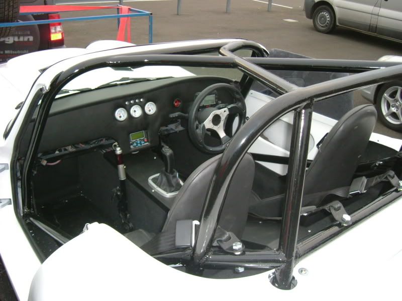

I need to relocate my handbrake, the tunnel is now getting a little tight at the rear. I'm faced with widening the rear propshaft-exit hole or moving the handbrake assembly.
Currently, it's the Westfield top-tunnel mounted assembly, Sierra cables to Sierra calipers. Would be great to relocate this out of the way, tunnel side mounted on the passenger side with a vertical lever???????
What are you currently driving that has this arrangement?
Thanks for any help.

Raw (fitted in the striker) will do you a set up for not alot of money, i puy one in the avon to get it out of the way

Mine is side mounted (Book/Ron Champion Locost) .....

the stylus is side mounted as standard, it uses a stock lever i think.

the majority of the Sylva stable are done in this way...

THANKS GUYS, I thought I'd seen a side-mount on a competitors R1ot, it must have been so.
Antnicuk - that's exactly what I'm looking for.
Far easier for me to weld a plate down there than go hacking the rear tunnel and wishbone mountings apart.
Now to find Messers Sylva and Raw, credit card at the ready.

It's a stock Mk2 Escort handbrake lever - shouldnt be too hard to find ?
