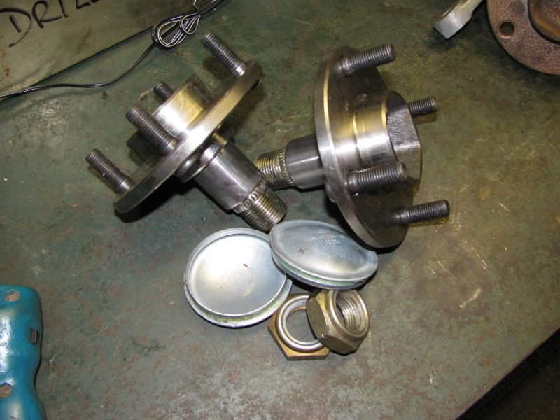

Finally managed to get my hands on some shiny wheels, but on putting them on my hubs (just test fitting) there seems to be a 4-5mm gap between the hub and the wheel, despite the front bit of the hub being snug to the centre cut-outy-bit of the wheel.
Do I just need a spacer, or have I buggered up somewhere?

mcerd1
posted on 13/5/09 at 02:46 PM Reply With Quote
whats it like with the disc on ?
or
got any pics with the wheel off?
I take it they are sierra hubs?
what kind of wheels are they?
[Edited on 13/5/09 by mcerd1]

Staple balls
posted on 13/5/09 at 02:53 PM Reply With Quote
HA!
I'm a twat.
mcerd1
posted on 13/5/09 at 03:07 PM Reply With Quote
it took me a few minutes to work out what was missing in your pic
you can just see the 2 diamiters of these ones:
http://i5.photobucket.com/albums/y170/mcerd1/IMG_0090.jpg

posted on 13/5/09 at 05:11 PM Reply With Quote
My wife spotted that
