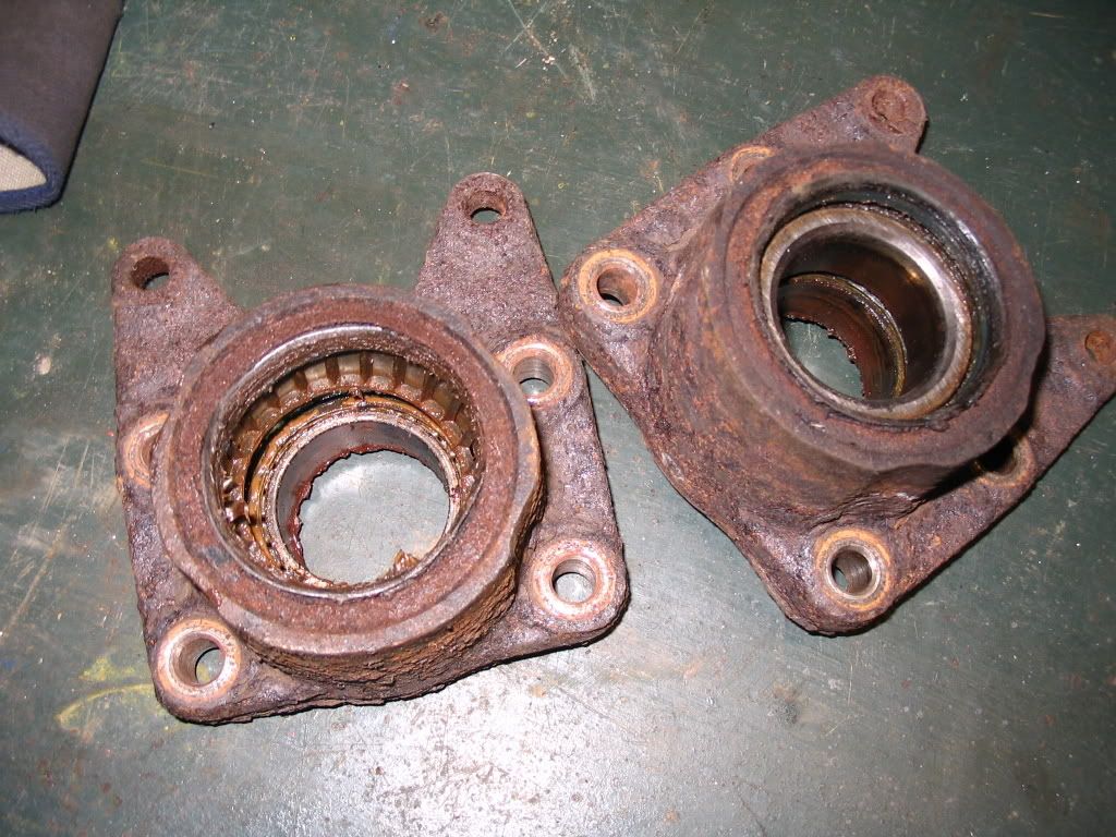

here's a few pics:
hub carrier with whats left of the old bearings still in them... (half of one fell off !)
and the carrier after I knocked out the outer bearing races (as mark said ^^^) and cleaned them up a bit
you can see the ridge in the midle that seperates the 2 bearings:
