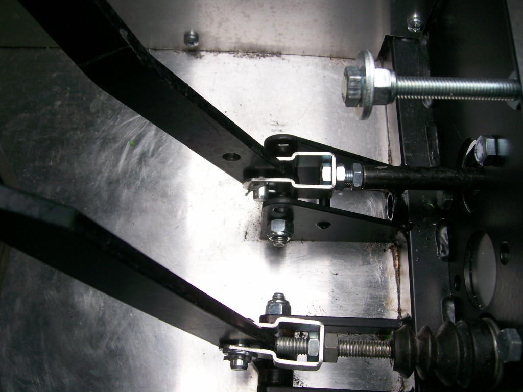

Frosty
posted on 19/5/10 at 11:16 AM Reply With Quote
A hole in the pedal, a clevis clip (or bolt inside a bush to allow rotation, and a strong bracket will do the job nicely.

frosty nice pedal box.
