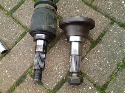

| posted on 5/7/10 at 05:50 PM |
the splines are very different from what I remember...
What you have with drum brakes is on the left in the photo. On the right is my solution, a very rare beast, lobro stub for drum brakes from an early
euro xr4x4.
Below is an image I have nabbed of the disk stub. The splines are longer and smaller diameter.
flak monkey
| posted on 5/7/10 at 07:35 PM |
Thanks, yep just managed to undo the hub nuts on mine and they cant be interchanged.
So I am after some brakets for my rear calipers. I'll take come comparison pics tomorrow. The hubs are quite significantly different.
