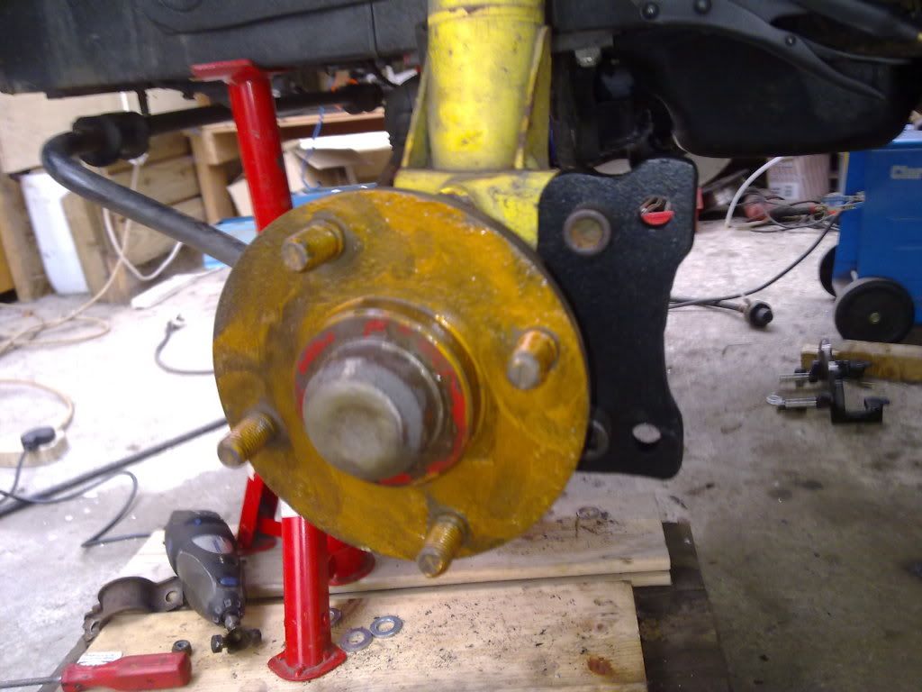

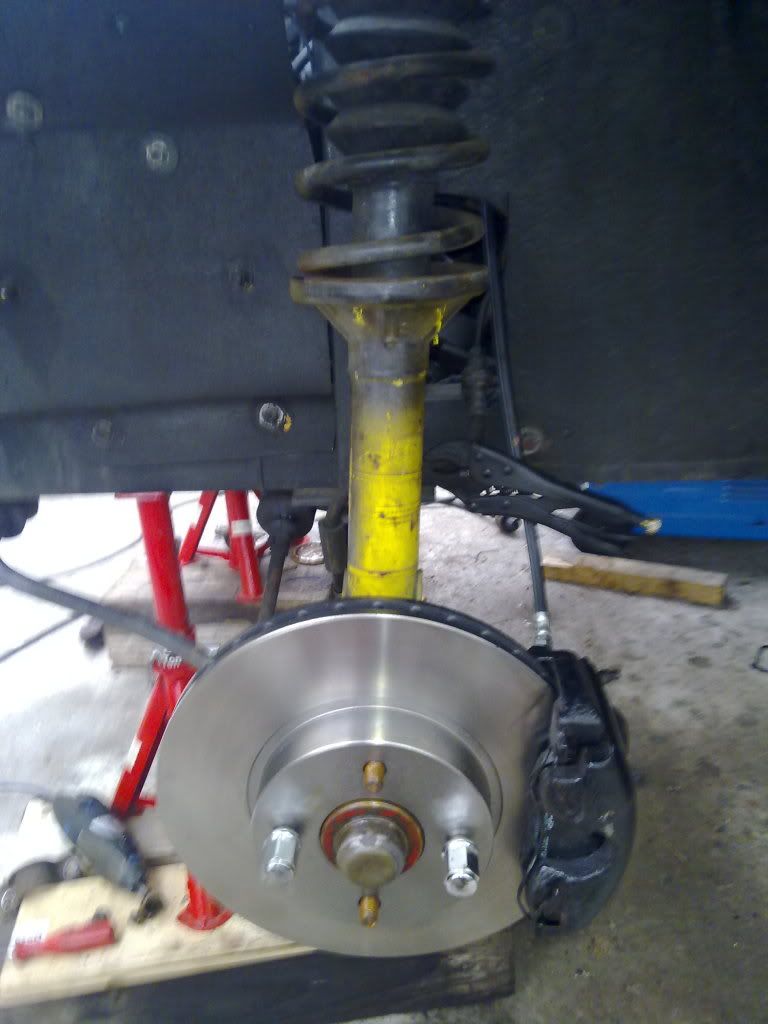

I needed something more confidence inspiring than standard escort solid disks on my jeep and they needed a full overhaul anyway, so for minimal cost I decided to sort it out.
I spent a few hours knocking up some brake adaptors so I could fit mondeo calipers and 2wd cosworth 283mm disks
I replaced the wheel bearings in a pair of hubs Id machined down slightly in the lathe and fitted them, then cleaned the mating surface with a dremel and applied copperslip
and the new disks followed by the calipers.

Why is one of your struts yellow and the other black?
Do you have the dame discs for front and rear?

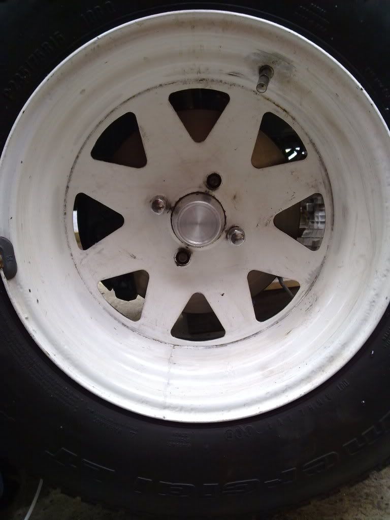

Why did you only use only 2 studs at your wheel? Is it a new way of weight reduction?

I have no idea, same as one is gusseted and the other isnt! Ill be swapping them out for something better as soon as I have some funds.
No, rear is on 8 inch drums and Im running with no rear restrictors inline
because I only dropped it on for the pic, the studs are too short with the disk sandwiched in there and I need new ones.
