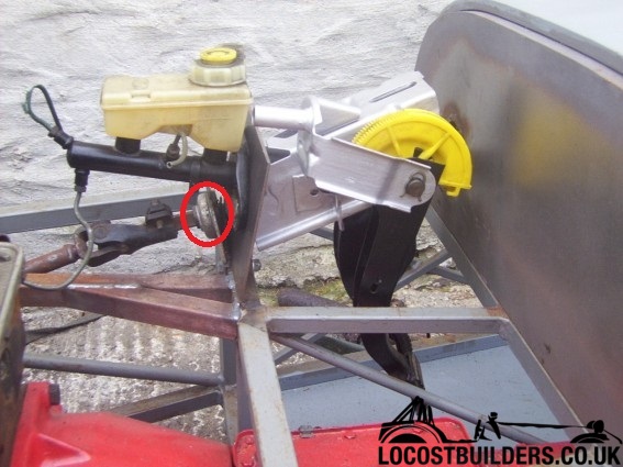

Steering column question. Sierra.
anyone know what this is called
http://locostbuilders.co.uk/upload/pedalissue.jpg
its the steering column bracket with the triangle in.
i need one if anyone has a spare one too.
could do with help.
cheers
adithorp
| posted on 11/8/10 at 03:30 PM |
It's the lower column bearing. Comes as a kit, 2 plastic bits and the rubber.

| posted on 11/8/10 at 03:49 PM |
Hi
It is std Sierra parts so should be available from just about any motor factors for little money or if feeling flush from a ford dealer.

doddy
| posted on 11/8/10 at 04:28 PM |
there on ebay item 260643540751

| posted on 11/8/10 at 05:51 PM |
better bet would be to fit a self aligning bearing

| posted on 11/8/10 at 06:48 PM |
Hi
The only reason to fit a self aligning bearing is if the top and bottom mountings are not aligned ( rather obvious ). Which is a common problem to
only two manufacturers otherwise the Sierra unit work just fine.
Those self alignment bearings look like something rather agricultural.
And just look at all the extra weight added to those BEC cars.
Cheers Matt
