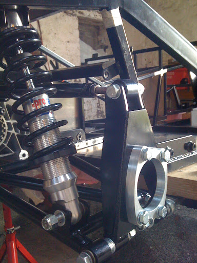

My shocks are 12.5" open length, and I think they would reach maximum extension before allowing that much droop. Here's a photo of my rear suspension which gives an idea - sorry its a bit of a crap angle!
I wouldn't worry too much about the assymetry in travel, maybe just due to a slightly thicker weld on one side? Also, I think the position of the lower 2x1" box section onto which the suspension brackets are welded is probably not jigged to a great degree of accuracy - I can see that one of mine is not quite straight - I guess its the position of the suspension brackets that is the important bit!
