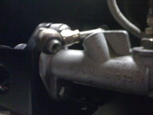

hi all,
any one know what master cylinder thread? i need a banjo for mine and its not the size ive got spare its bigger which is not much use to you i know but wandered if they were just two sizes

girling 625 i think it says
adithorp
posted on 5/2/11 at 10:26 PM Reply With Quote
The 625 doesn't really help as thats just the bore size, 0.625" or 5/8"
Common thread sizes are 10x1mm and 7/16unf you might come across a 12x1mm but I doubt it. We realy need more info or a crystal ball.

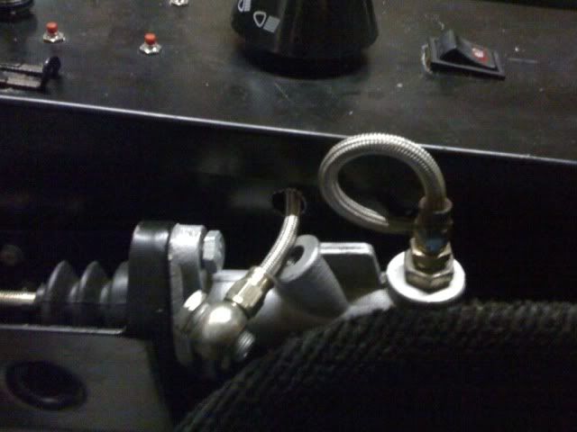

One for the fluid res will be 7/16 the one you want will be 3/8" 24tpi

The top of that nubbin where the banjo is trying to seal isn't a machined surface so you may have trouble getting it to seal. If you do have trouble, try a thicker copper washer.

As said the inlet is likely to be 7/16"UNF and the outlet 3/8" UNF . A grommet on the hose where it goes through the panel would be a good idea as well

thanks guys, ill order one of each anyway, got some grommits to stop it rubbing this weekend
