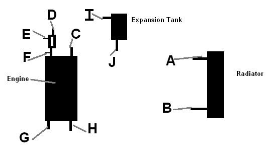

Can anyone help me with my plumbing jigsaw?
well im almost ready to start plumbing my cooling system, but TBH i dont have a clue where anything goes to, so if anyone could help me that would be
great.
the engine is a 2008 R1, VW polo Rad, and rover 25 expansion bottle.
ive made a diagram of all the connections here:
and the key:
A - Top of Radiator (32mm)
B - Bottom of Radiator (32mm)
C - Top of Engine
D - Thermostat (30mm)
E - Tiny (8mm) hose before thrmostat
F - Tiny (5mm) hose after thermostat
G - 13mm hose that goes onto the water/oil pump
H - Bottom of engine (25mm)
I - Top of expansion bottle (8mm)
J - Bottom of expansion bottle (17mm)
So if anyone could help me where the hoses go to that would be great, and much appreciated.
thanks
james h

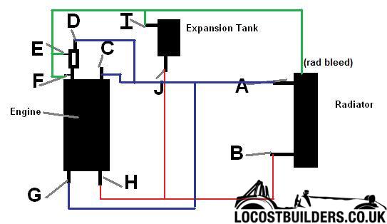

| posted on 30/4/11 at 12:50 AM |
This would be my best guess but someone will be along to correct this most probably:
StevieB
| posted on 30/4/11 at 06:59 AM |
^^^^^^^^^That's roughly how I plumbed my 2000 5JJ R1 engine and never had an issue with cooling. I don't know if the later engine is any
different though.

| posted on 30/4/11 at 08:54 AM |
Thank you very much james, that looks nice and easy.
My only problem is my rad doesn't have a small connection on the top for the green line (rad bleed). So can i just take this off the top hose?
Or do i need to do something else?
