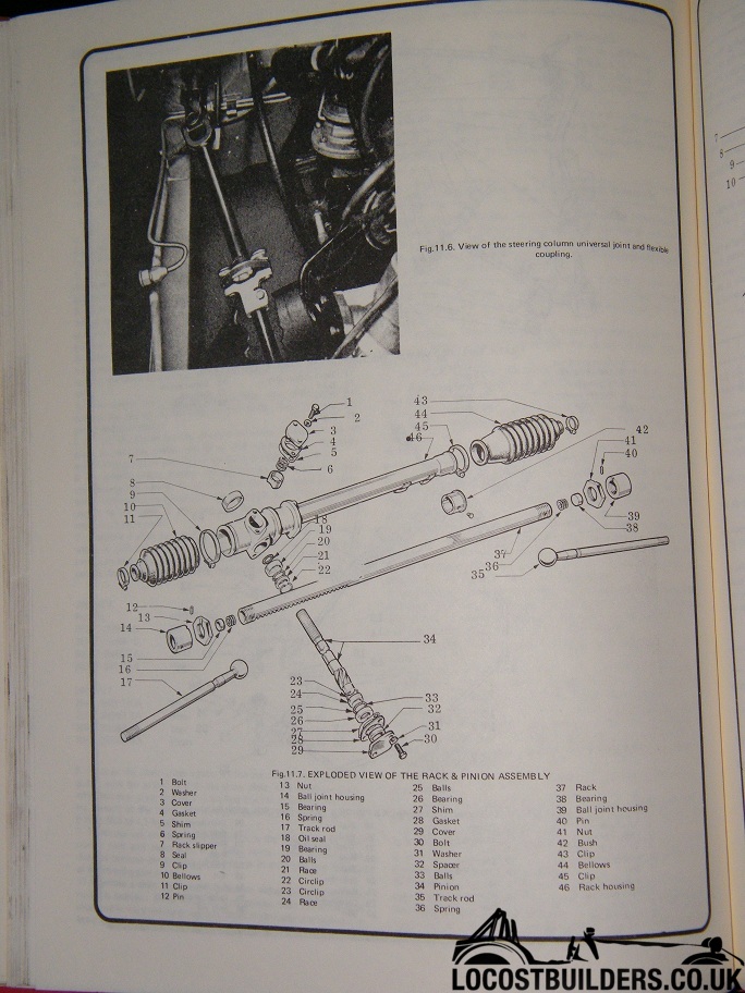

Does anyone have one of either rack, or can point me in the right direction?
I made the mistake of removing the pinions from both at the same time and doggy decided to traipse through the garage scattering my two little neat piles of separate parts into one big unfathomable pile!!!

might have a haynes book somewhere - I'll check later...

this is for a Mk1 capri
