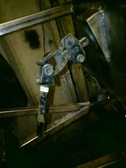

With my Haynes came a Sierra column and an Escort rack but nowt to join the two together. Is it one of these I need to extend to do the job?=

The sierra spline (rack end) is a different size to the escort rack. Your better off buying the couplings off rally design. I learnt the hard way.

I don't think this is always true. My standard Escort rack fitted up to my Sierra downlink.
It may be something to do with the power steering Sierra downlink and rack that have a different spline.

I think you may have a point. It definately says in the book that you can extend the Sierra item to fit onto the Escort rack. So that must be from a base model with a manual rack. My box of bits came with one of these-
And one of these, but the splines don't fit the Escort rack-

Not sure about the Sierra power steering column down link fitting a mark 2 Escort rack but the Sierra manual column down link is the same size . There are at least 3 different Sierra downlinks , some are thicker and can cause clearance problems with the chassis . The Rally design column is approx 14mm in diameter and can be extended easily, they also do a coupling to join the upper Sierra column and a U.J to fit the Sierra or Escort pinion
