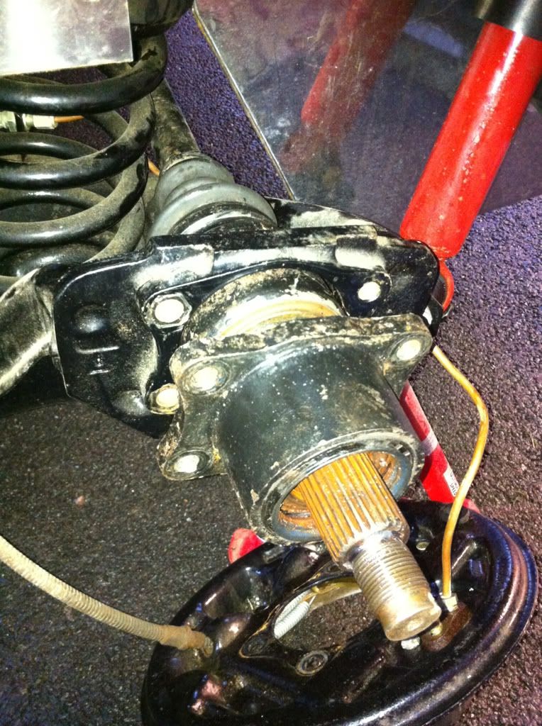

I've got the drum and back plate off (hub/bearing carrier was incorrectly fitted behind back plate) and now the hub won't come off the shaft.
Photo for clarity...

Two long bolts + nuts and a piece of steel angle across the shaft end

Has the bearing pulled off the hub or has the whole shaft moved through the carrier?
Get a couple of pieces of wood or RHS and put them behind the bearing carrier then tap the shaft back through the bearing, might need to respace a couple of times.
Couple of observations.
I wouldn't bend and straighten copper brake pipe too often, it work hardens and will crack.
What is the orange gunge on the shaft/bearing? Looks like rust and grease in which case bearing is knackered.

Thanks daviep and jacko. Had just come to that conclusion myself though losing light so had to reassemble to tackle another day.
Gunge is grease, possibly contains rust but not sure if from bearing or not, bearing seems smooth.
No excuses on the brake line though...O
