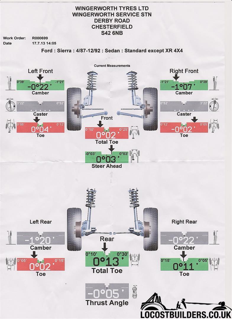

Geometry check opinions
After doing a very rough set up, took the MK for a Geo check, the camber is as taken and will be sorted asap,
Comments on the rear toe and thrust angle would be appreciated, good enough or needs shimming?
Front toe OK? feels OK.
posted on 17/7/13 at 04:29 PM Reply With Quote
If I'm reading it right, the rear toe and thrust angle don't look too bad at all. Certainly better than my Indy was "out of the box". If anything you might shim the rear left for a little more toe in, but you might struggle to make that fine an adjustment by shimming the hub from the upright.
britishtrident
posted on 17/7/13 at 07:39 PM Reply With Quote
Not too bad ---
Were the readings taken with the driver onboard? That can make a difference to toe and camber on a light car.
