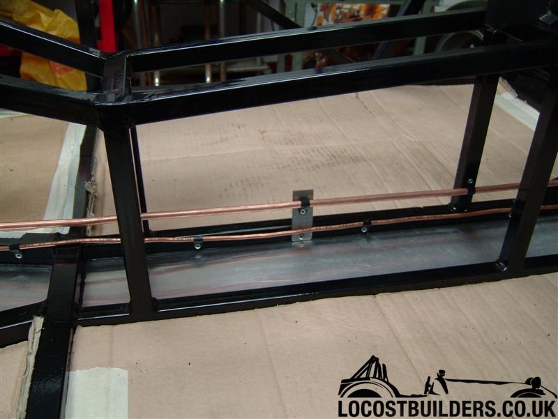

mike smith1
| posted on 5/7/06 at 07:59 AM |
As above
see pic:-
[Edited on 5/7/06 by mike smith1]
mike smith1
| posted on 5/7/06 at 08:00 AM |
try again!.JPG)
