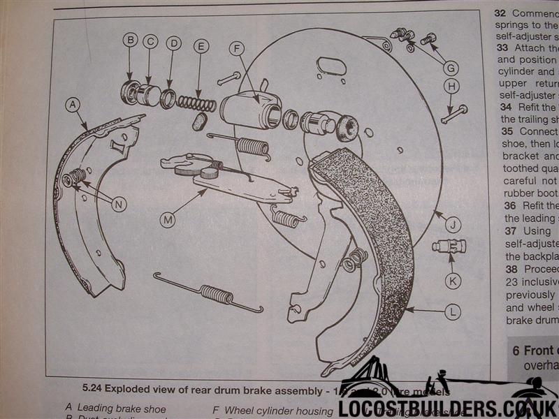

I took loads of piccies upon disassembly but am still a little confused on a couple of spring positions...
Any chance anyone has the relevant Haynes section scanned or a useful picture?

Fairly straightforward mate, but I managed to make an ar5e of it
Just ensure you fit the drum back plate on the inboard side of the hub, not the outboard. Otherwise, the drum catches the back plate and it goes a lovely cherry colour
Rgds
Richie
RichieC
posted on 10/7/06 at 12:05 PM Reply With Quote
1.3 / 1.6

Ta for that Richie.
Should be able to get it sorted now!
