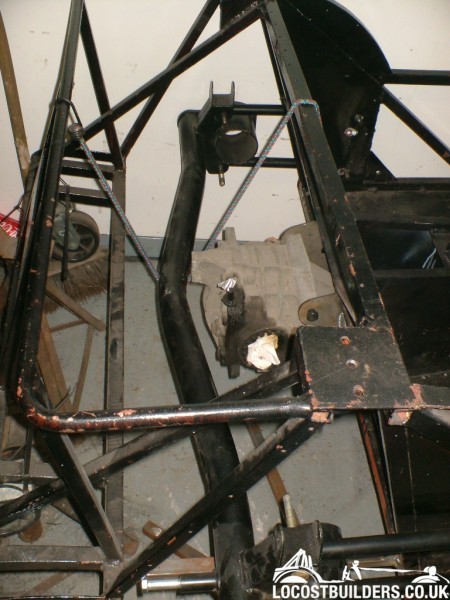

i am in the process on installing a de deon
some pics in my profile.
