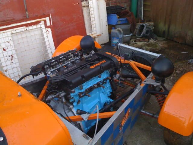

beaver34
posted on 2/12/08 at 07:50 AM Reply With Quote
here you go also, not much i know but will be at some point!
ReMan
posted on 2/12/08 at 07:58 AM Reply With Quote
Nice.
LHD too?
beaver34
posted on 2/12/08 at 08:00 AM Reply With Quote
Originally posted by ReMan
Nice.
LHD too?
yes, for now but prob for ever, ill get used to it
