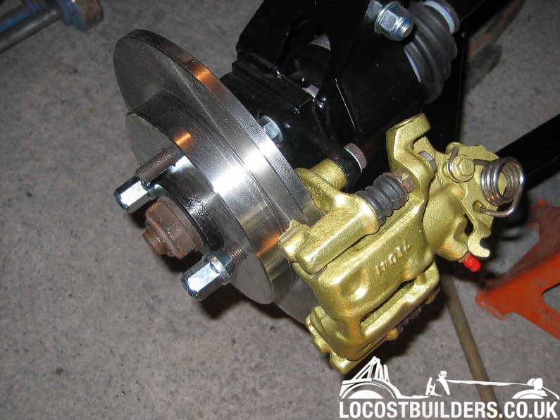

mackei23b
posted on 7/1/09 at 09:41 PM Reply With Quote
Here are mine on the MK
jimgiblett
posted on 8/1/09 at 12:11 AM Reply With Quote
Curiously thats the second MK I have seen with the calipers on upside down (ie nipple at the bottom).

RickRick
posted on 8/1/09 at 07:22 AM Reply With Quote
i know mine are fitted upside down, as the handbrake cable is difficult/impossible to route with the caliper the right way up
