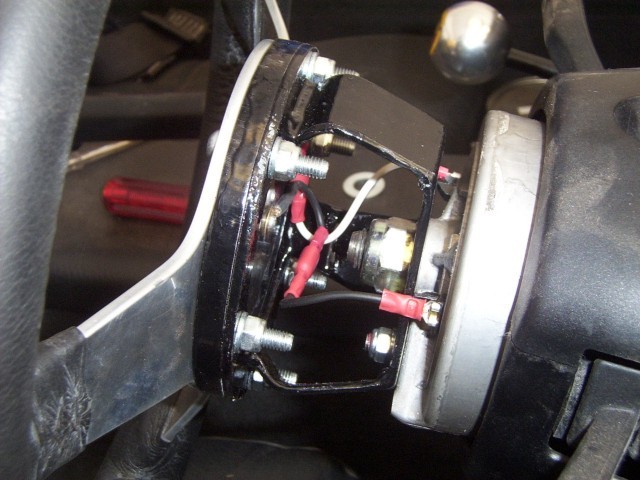

Where to buy collapsable boss? & Identify the steering wheel plz
  boss side
  Wheel
please can you help identify the following wheel so I can buy the correct collapsable boss, then I could also do with some links to companies that
sell afore mentioned boss
Also can anyone give me any pointers on how you would secure handbrake cable to actuation lever on back of drum?
  handbrake cabel
I'm thinking thin bolt, but is there a proper connector I should be using?
Thanks!

Going by the size of the bolt spacing it looks like a mountney traditional.
Im not sure if they actually make collapsable bosses for this type.

Not sure of the steering wheel, but I have a spare one exactly the same on my shelf! It came in a Moutney box, but I do have other Mountney wheels
kicking around.

i'd agree with mountney too.

Same wheel as mine too - a Mountney. Just checked mine for markings but not a thing on it! Same wheel though.

A Mountney wheel, unfortunately the bosses are of terrible quality, but why not make your own?

2 uj's, column will pass, but as steering wheel is not a sierra one i need a boss that will deform if i hit it (eg rear shunt)

That covers the column, and therefore a frontal impact, this is if for some STUPID reason I got thrown forward INTo the wheel it needs to collapse
from that way too.
Daft as I will be wearing a seatbelt and be miles from the wheel (monkey arms)

It looks like an old-style Mountney wheel. Collapsible bosses don't fit. I solved the same problem in a hicost way by buying a current
collapsible boss and a solid distance piece, both from Europa and drilled the distance piece to suit the different pcd of the wheel and held it all
together with csk socket screws.

You can get collapsible bosses for Mountney wheels. They're made by Astrali. Picked mine up from an autojumble for a fiver.
