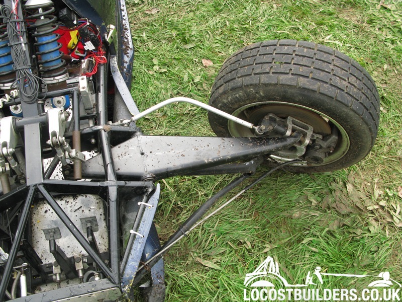

Floating front upright design
Has anyone made or better still got plans for racing style front hubs (like pic below) with a floating i.e. rotates with the week front axle?
Fabrication wise they look quite easy, light and strong but looking for more info on the design detail

The only thing that you should build into that set up is some sort of wishbone adjustment, like rod ends on the wishbones.
Otherwise you will be stuck with the wrong wheel alignment if your chassis is the slightest bit out and most amateur ones will be.

I made my own.
You just need a hub and bearing to measure from. A donor hub helps too.
The main things to remember is to work out your scrub/kingpin inclination in relation to your tyre patch. Also you will need to work out where the
caliper mounts will go.
Just getting a cad drawing from someone else will mean nothing if they are using different wheel size, tyre size or offsets.

Chaps what are the advantages of a "floating" design over a conventional stub axle? There must be some of people would not use them but
I'm blessed if I can see them.
Regarding adjustability using the outer rose joint to adjust camber id fraught with dangers. The shank of the rose joint os alreadily heavilt loaded
in bending and adjusting it outwards magnifies the problem - using the inner rose joints where the load is spread over two joints is a better ideas.
If you are interested Aurora Spherical Joints pyblished an article on how to calculate the loading very simply - i think it is available on thier
website.
Another way th adjust camber is to bolyt the fixing for the rose joints on with a brachet which can be shimmed thus avoiding extending the rose joint
shank.
Also has the advantage if you make the fixing bolts small enough in a crash they will shear off rather than twist the chassis mounting points.

I think he means 'floating' where the the stub axle rotates on bearings in the upright,
A simple idea for uprights is to get a set of Mini/Metro, cut off the top and bottom pivot mountings and turn the body to make a bearing housing to
weld to.
Mark Allanson
| posted on 1/2/09 at 07:23 PM |
Basically just a driven hub without the drive then, you would need to turn down the outer Cv joint to maintain tension on the bearings

Like mine:

Yes but why do it? I may be being dense but blessed if I can see the advantage - I must be missing something here.

There is one big advantage......not having to compromise.
When you use a ready made item, you accept it's design limits and settings.
If you want to run a different wheel size, then kpi and scrub will be altered. Your steering rack position is determined by the steering arms on the
hub and therefore dialing out bump steer is a problem.
My rack is parrallel to the top wishbone so it runs in the same arc....no bumpsteer issues.

Does it not increase the unsprung mass and therefore degrades the suspension performance?
nitram38
| posted on 2/2/09 at 06:51 PM |
Why?
Do you think that my hollow plate uprights could be heavier than solid cast items plus the mushroom adapters required?
Even my rod ends are lighter than ball joints.
