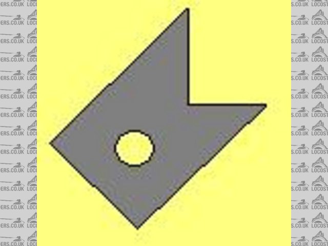

| posted on 23/3/09 at 09:11 PM |
yes, i had thought about that, perhaps a bracket with a corner cut out the base of it, so it would be welded to both the side and bottom of the
rail?
like this but make it a bit prettier
